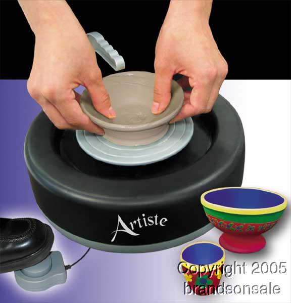

I'm thinking about something like this for a 'motorized scarey sharp' setup. Cut some 5" plate glass circles to dbl tape on the wheel with sandpaper glued on top. Trip to Toys Are Us coming up.
